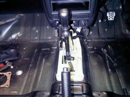

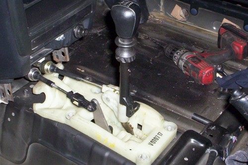

Hey fellow tuners... I've done a conversion on my car using the sr20ve '20v' 6 speed from the p12 gt which is the NA version to the sr20VET that the x-trail gt comes with...i was wondering if any of you know if the manual shifter is the same as the p12 gt, reason being is that i did not get the correct shifter with the motor and the gear shift's are opposed, if you can confirm this it would be sincerely appreciated!!!...I will upload a picture of the p12 gt shifter so you can use as reference...thanks in advanced!..
