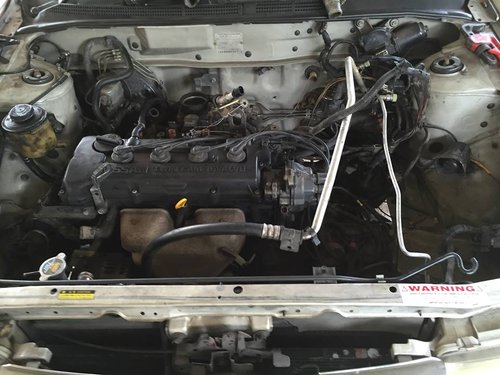

After yrs of a oil leaking B14 engine it stopped and decided to start burning oil. It was Quart every 6 months then Quart every 2 months to last month Quart. I got fed up of trying to get a head and block and took the plunge Qg18de with box.
[attachment=4]11091147_10153091068760901_620097423622136360_n.jpg[/attachment]

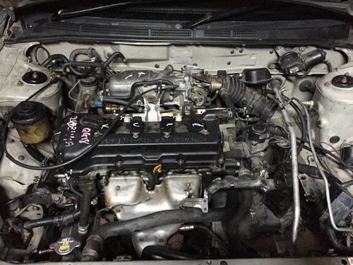

TO
[attachment=3]11081163_10153091068755901_6464031588704206510_n.jpg[/attachment]

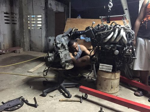

This is when i now got it
[attachment=2]11082565_10153092340250901_5479256365776178759_n.jpg[/attachment]

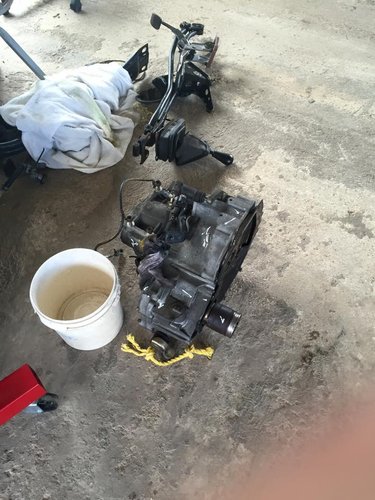

[attachment=1]11081197_10153092340800901_4336106208838191214_n.jpg[/attachment]
It came separate but with an automatic trans harness
