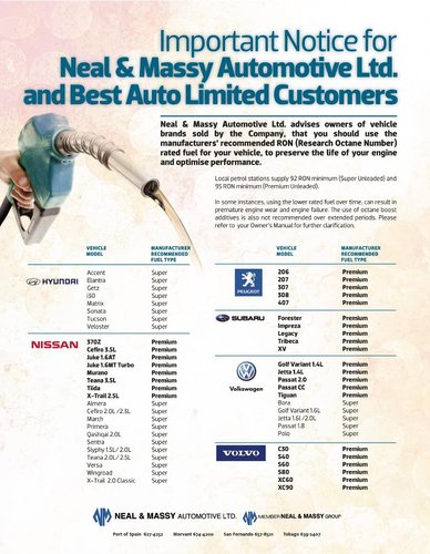

Update

^^^good update....

really good update.....funny though....the tiida needs premium while the sylphy takes super......
sylphy being the bigger and more spacious car is the better buy now....
so will price of tiida go down?.......since its now more expensive to full up?.....

Thanks for the update

based on that update...so all those old peugeots should be running on premium?

Neal and Massy is not straight-forward with its fuel octane recommendation for Nissan vehicles, the Tiida Sylphy and Versa all use the same engine. (Read between the lines!!!!!) You have the power of your wallet NOT Neal and Massy

Actually the HR15de runs lower cylinder head temperature than the HR16de hence the lower octane requirement. The reason behind this is the HR15 has a shorter stroke enabling the cylinder head to be a bit larger with bigger water ports cut into the head.

According to the Nissan Manual on the Nissan Tiida HR15 engine...RON91 Minimum can be used! Yes you can use Super Unleaded RON92 in your Nissan Y12 Wingroad.
But you will lose engine power if you use Super RON92 since the ECU will automatically reduce engine timing in order to accommodate the lower Octane (RON) level.

So I'm seeing in the flier above you can use super for a Wingroad but the Tida uses premium.. Any specific reason why? I have 2011 Y12 and just looking for what fuel I should use..
