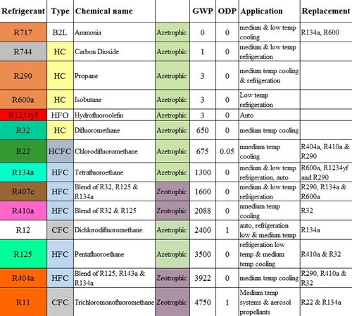

Soon? A number of manufactures have already switched.
But just like R22 there is stock for all the vehicles still using R134A. I am very open to correction but hybrid vehicles use 1234yf as well as korean built rides.
And just for rushing me hold this and the ozone cycle.
