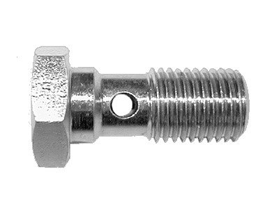

Also : Make sure Banjo Bolts are in the correct places allowing for seamless passageway where the brake fluids can flow. My last quack mechanic mixed up the banjo bolts (one with holes) with regular bolts (no holes) restricting passage way for the brake fluid to flow.
Banjo bolt.gif (21.9 KiB) Viewed 3869 times

haydn0 wrote:Also : Make sure Banjo Bolts are in the correct places allowing for seamless passageway where the brake fluids can flow. My last quack mechanic mixed up the banjo bolts (one with holes) with regular bolts (no holes) restricting passage way for the brake fluid to flow.
Oh geeze! I've actually never checked that. Will follow up and advise you guys tomorrow! Really appreciate the help! :D

brakes will never work if the creature (can't call him a mech if he so dotish) put regular bolts where banjo are required. Those bolts are a special fine thread as well so where he got solid bolts to put in there is a testament to his skill.
