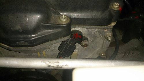

Postby Mosaic » July 9th, 2015, 1:03 pm
Found the cam..
can't find the crank...do i have to go under the car to see it?

Re: WTK location of Y11 Cam & Crank sensors
Postby Cheddar » July 9th, 2015, 8:58 pm
It located under the intake manifold. It will be hard to see from on top unless you know where it is. So try to get to it from below.

Postby Mosaic » July 9th, 2015, 11:03 pm
Ok thx....tried removing the cam sensor today...but it wouldn't come out. I can get it to spin but even prying with a flat blade couldn't get it out.
Postby racedriverpro » July 9th, 2015, 11:18 pm
Ummm...remember that the hole in fits into is very snug so prying from one side will not work. Try prying from opposite sides using equal force and see how that works. You can do it.
Postby X_Factor » July 22nd, 2015, 8:51 pm
the crank is on the far side of the oil filter and closer to where the starter bolts on
accessing it from under the car seems easiest
