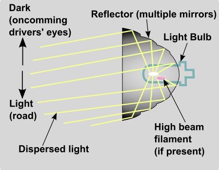

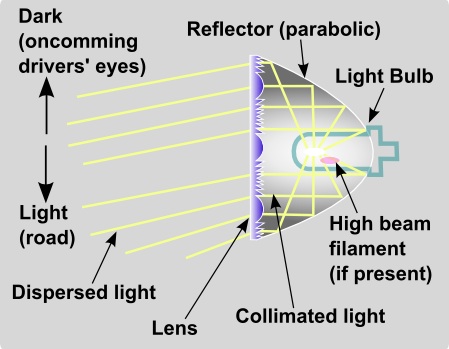

Anyone ever removed the shield located inside of some vehicles headlights? is there any adverse effects of doing this? Just looking for some feedback.
Strugglerzinc
Posts: 4043
Re: Shield inside of headlights
Postby Strugglerzinc » November 6th, 2013, 2:13 pm
Most of the bits inside a headlight are there to ensure proper reflection and aim. Removing a piece can cause dark spots or worse.

I think i may have explained my self wrong? From you diagram above, which shows the light bulb in the reflector, the shield i'm talking about is located in the reflector and the light bulb is inserted into it

I don't think you want to remove that shield. The heat from the bulb would just burn the heck out of your headlamp and that shield acts as a reflector to emit the right amount of light and in a more user/road friendly way.
