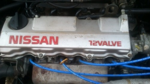

have a B12 fuel injected original. on mornings i will get a hard start will have to tumble three or four time to get it going and when it do start it will tremble a bit.if i park for about two hours the same thing will happen, had it check out.
the mechanic change the fuel regulator,fuel filter and the fuel pump. still the same problem.
i have doubts about the fuel pumps.
why,
cause its a b12 injected and the pump are hard to come by. but he said he change it.
i need to know is it the fuel pump or some thing else
