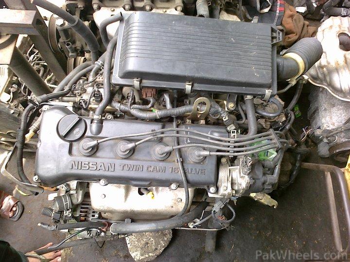

cinco wrote:the tiida has a plastic valve cover???
The GA's seem to be plastic. Dunno if it's different in the tiida, hence the question.
Posts: 18412
Re: Faulty Brainbox?
Postby Dave » August 8th, 2012, 4:01 pm
local GA's were aluminiun and FU units were plastic
spidey, the jacks for wire harness and contact points for plugs were ever cleaned and lubed back?
something is creating a hot spot causes additional voltage to get to the plug
