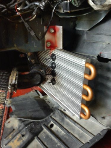

my car ran cooler
check teh pics
sport mode was enabled to run longer
if you using the fan, make sure it does not hamper the air flow

did mine over the weekend after soo long...
for a cheap mod its worth it.....noticable engine temperature drop during the day and more noticable during nights and with A/C on

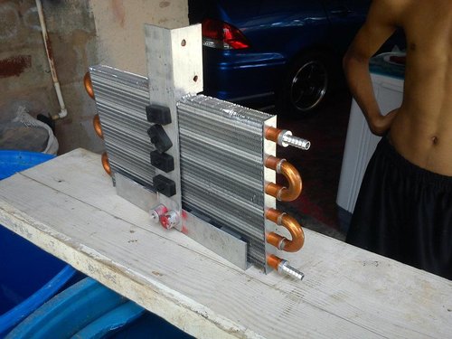

oil cooler makes a huge difference......i am currently still running an experiment with mine
VR4 TwinTurbo AWD auto with Tiptron mode using cheapest tranny fluid but using a "oil cooler" which used to be an AC condenser for a E24 maxi which is big.
Cools the oil way down then I pass it back through the radiator to warm it back up to operating temp.
This cheap oil still has the same colour an smells the same as when I first put it in must have driven it hard for 15,000KM so far

xtech
Posts: 3004
Re: Effect of upgrading oil cooler on CVT - installed with p
Postby xtech » April 2nd, 2012, 7:38 pm
too small for my INVECS-II tranny but will be a good upgrade from stock in our climate for those low powered INVECS-II and INVECS-III CVTs.

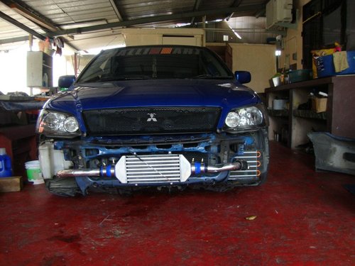

my trans cooler away from the radiator and i break off my fog light bracket so that air passes through it . thinking about hooking up a fan.

My INVECS-II is connected to a motor with twice your horse power in a car twice as heavy as yours.
Plus it's AWD.
I get a very good cooling effect but no low oil pressure warnings or readings. Not saying you should go as big as me... cause you can't even if u wanted to just saying I did an it works well. What you got there will work well on my car in a cooler climate. But will better suit you in our hot climate.
Oil cooler is similar to what you got there but is 4 times bigger an can only fit in front my radiator where its conviently cooled by the dual radiator fans when the car is not moving.
heat is worse enemy of any INVECS an we have lots of hot days here most of the times stuck in traffic.
