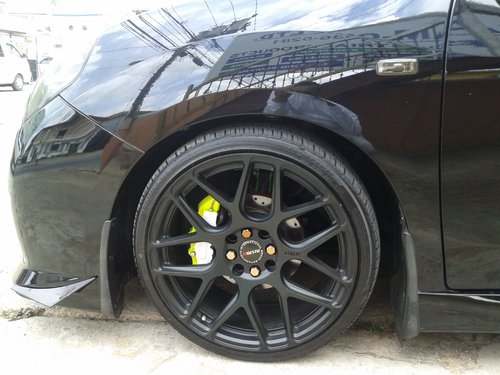

Postby Seedragon » July 1st, 2016, 3:00 pm
fellas
I upgraded the rotors (Vented & Slotted) and got some good pads to go along with it, also I changed the Brake fluid to DOT5 --- YES dot5, the brakes feel and respond way better ... you notice it right away. All I need to do is the Stainless steel brake lines ... BTW can any one get these for me??
Rear brakes poses a challenge as I have no time to go by my pal in the bamboo to do a scrap down trial and error which may take 2 days..
I running Fake rear rotor and caliper ...LOL real thief head business.
Seedragon
Posts: 81
Joined: April 22nd, 2009, 2:13 pm
Location: North / East
Re: WTK - Y12 front brake upgrade
Postby Seedragon » July 1st, 2016, 3:04 pm
Check it out
Seedragon
Posts: 81
Postby Seedragon » July 1st, 2016, 3:05 pm
The back shot
Real thief head thing.
LOL
skylinechild
Posts: 5692
Location: In a Skyline
Postby skylinechild » July 1st, 2016, 9:43 pm
Seedragon wrote:fellas
you said vented and slotted - the pic shows the rotor as being vented and cross drilled.
which rotor did you use ?
did u use another size Nissan rotor from another vehicle and shave / re drill to use or did u special order the rotor from another company.??
reason why i'm asking is that now you have upgraded your stopping power the brakes will generate alot more heat. the problem with just cross drilling the rotors - if you in fact did that - is that you get hot spots and cool spots on the rotor surface.
long story short - the rotor begins to crack - by the holes on the rotor and these cracks spread to other holes on the rotor surface - and so on and so on - thereby weakening the rotor...till eventually the rotor cracks or shatters.
i'd actually advise you getting it slotted instead of cross drilled.
some manufacturer rotors are cross drilled from factory - these are designed - due to the metal used and the rotor construction - to be able to withstand the cracking by the holes - within reason....
that being said cross drilled rotors look cooler than plain stock ones...so you get the "racy / sporty look" from the cross drilled rotors.
btw see your pm.
btw see pm.
