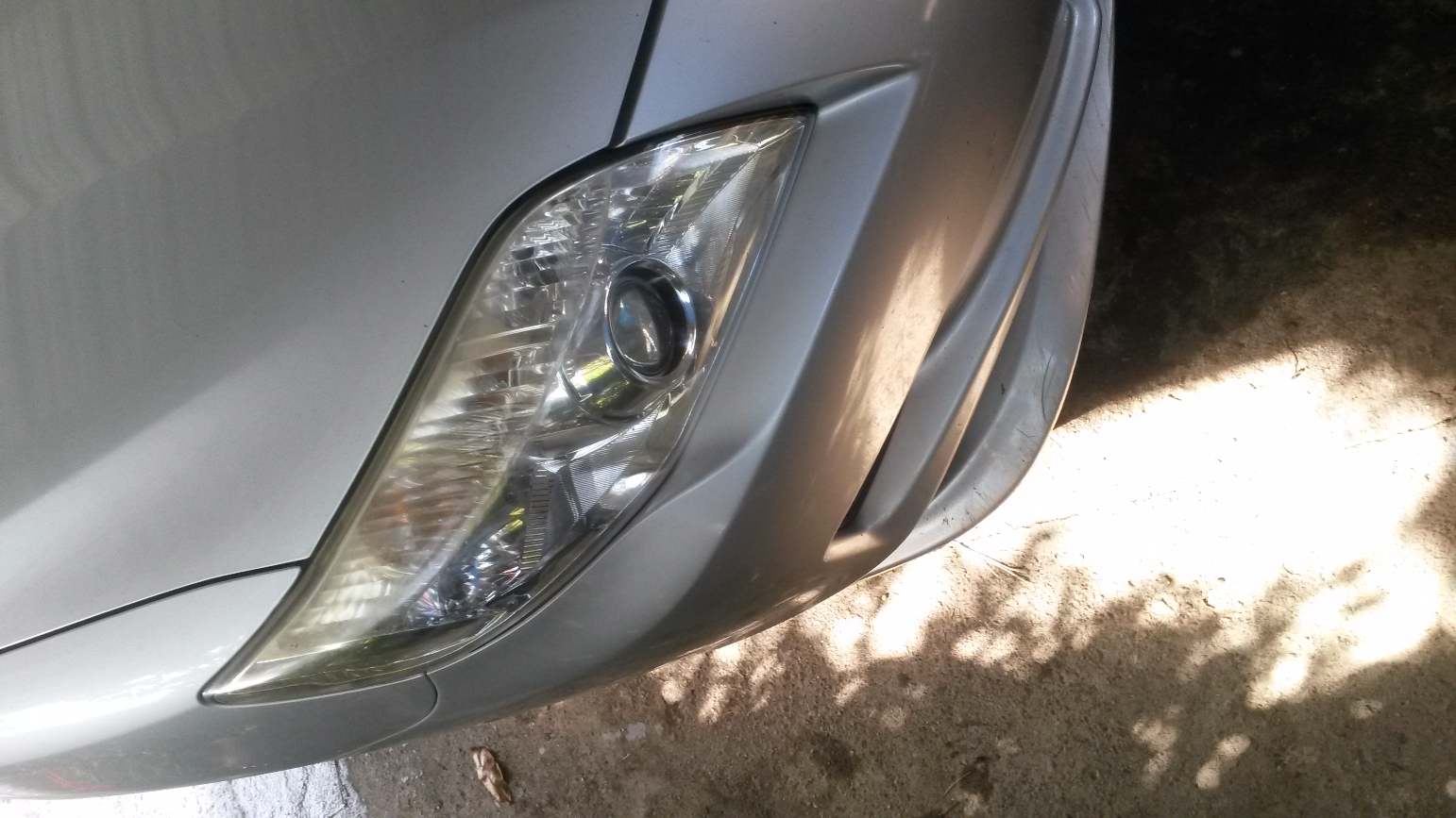

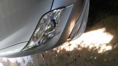

I use Mother's Plastic Polish
Before:
After:
One polished. One unpolished:
The Mother's works ok once used every few weeks. Of course it does not provide a sealant that you may get in a restoration kit.

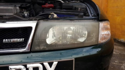

Been meaning to post this a while now...
Used the 3M Headlight Restoration WITH protectant on CK2 Lancer
Its pretty much just sandpaper in varying grit and an attachment for a drill..
Took about 45mins max to do one headlight..
Been 8 Months and the headlights are still clear!
Before
During
During
During
After (Car was going for much needed paint in a few months)
Re: Best fix for yellowed/ discoloured headlights?
Postby Morpheus » October 17th, 2015, 12:51 pm
^^Good result

Morpheus wrote:Plastic...
yup!
And still clear approx 8 months later without using anything on it.
Note that particular kit comes with a headlight protector in it.
