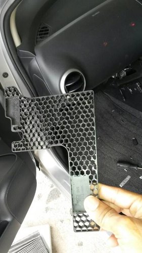

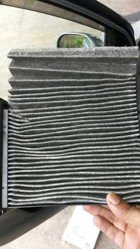

Hey I have an altis and checks reveal that there isnt any cabin filter. Some sites say u have to cut the plastic and put. In one any suggestions.

gundeleroy2k wrote:Hey I have an altis and checks reveal that there isnt any cabin filter. Some sites say u have to cut the plastic and put. In one any suggestions.
if it doesnt come with one doesnt that mean that there isnt suppose to be one?...
your regular ac filter should suffice...
ooaarrr if u health concious and try not to breathe in any dust at all then you should cut the plastic bigger and install two instead of one.
i think u get the point....if the ac functioning as it was meant to then dont dig it...you might end up in a hole u cant get out off

Re: The A/C problem thread. Check here first! (Mods plz stic
Postby X_Factor » June 17th, 2015, 2:53 pm
So i needed to change the A/C filter in the Nissan Note....most a/c shops quoted from 175 upwards
So i decided to try it myself and found it to be quite easy.
Step 1) you need to take off the glove box, it has 3 screws to the top and 2 to the bottom and then just apply a little pull/tug pressure and it comes out very easy
Step 2) there is a little piece of plastic tingy shown in the pic, its held by 2 screws, take those off and the plastic tingy comes off easily
Step 3) Use a flash light and you will notice the A/C filter at the back, sorta sandwiched between the center console and firewall
Step 4) simply push up and oull out the old A/c filter and replace with the new one....the nissan note carries the same filter as the Tiida
Step 5) re install screws, snap the glove box back into place and re install the screws that secures that.. and thats the end
probably took me 30 mins and i was still taking my time observing and taking note of stuff before i took it off....20 mins to take off and less than 10 to put back up
Total cost --65$ for the filter..most places sell it between $55-$70
