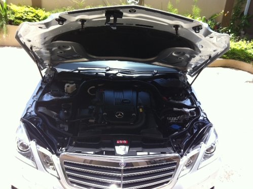

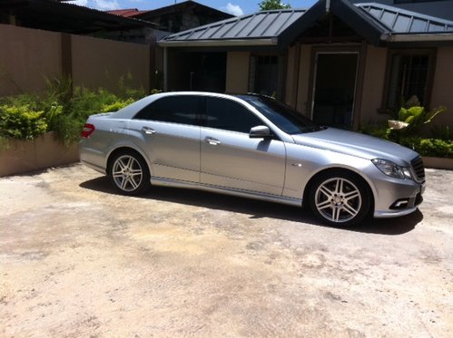

Hey guys what did you do this weekend?
This is was one of the vehicles i worked on.
The vehicle came straight out the showroom and into my hands. Customer wanted a paint protection. So i used something they guys in the Aerospace industry use..( i keeping this product a little secret)
let me know what you think guys !!!

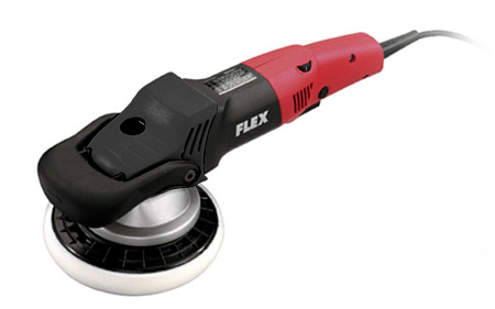

Ok guys i got my new toy and i cant wait to try it out!!!
This is one of the best dual action polisher money can buy;
Here is a little write up:
The orbital rotation of the FLEX XC 3401 Polisher simulates the circular movement of the human hand while polishing. This motion is less likely to cause holograms than a rotary buffer. At the same time, the polisher's highly smooth running facilitates a careful, precise finish and allows for hologram-free polishing.
Flawless polishing is just what the FLEX XC3401 VRG Dual Action Polisher was made to do. The positive drive ensures a uniform movement, even under load, thanks to constant lift. Taken in conjunction with the large stroke length the FLEX can remove existing holograms from black finishes.
The large stroke length refers to the size of the orbit. On many dual action polishers, this is a very small distance and therefore you feel a jiggling motion. On the FLEX polisher, the stroke length is 8 mm, a huge distance in terms of orbital polishers!
The FLEX Dual-Action Polisher has a true dual action motion. The pad moves in a forced rotation that keeps moving even when you put some pressure on the machine. This forced circular motion REDUCES VIBRATION. No more jiggling! The FLEX Polisher operates smoothly because of the controlled motion of the pad.
Thanks to the direct orbital drive, very little heat develops on the surface, which is ideally suited to temperature-sensitive finishes (i.e., “soft” clear coats). The FLEX XC3401 VRG Orbital Polisher makes it almost impossible to burn the paint! The accelerator trigger switch and speed selection allow for a controlled acceleration to the optimal speed. The FLEX Orbital Polisher’s smooth acceleration and uniform, controlled motion make this DA machine ideal .
The FLEX Orbital Polisher is rugged like a work truck but it has sophisticated electronics, like a luxury sedan. A seven-fold microprocessor offers constant speed control by tachometer generator, soft start, accelerator trigger switch, restart protection after power interruption, overload protection, temperature monitoring, and speed selection.
The FLEX Orbital Polisher is an outstanding professional grade dual action polisher. It is comfortable to use, well-made, and it works harder than a typical dual action polisher without putting your paint at risk of holograms. Most importantly, the FLEX Orbital Polisher eliminates swirls, scratches, and other paint flaws to leave the paint looking flawless.
Mercedes Benz use the the Flex XC 3401 VRG on their assembly line to achieve that glossy finish on all there motor cars.
I cant wait for this weekend !!!

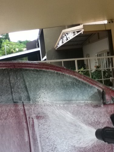

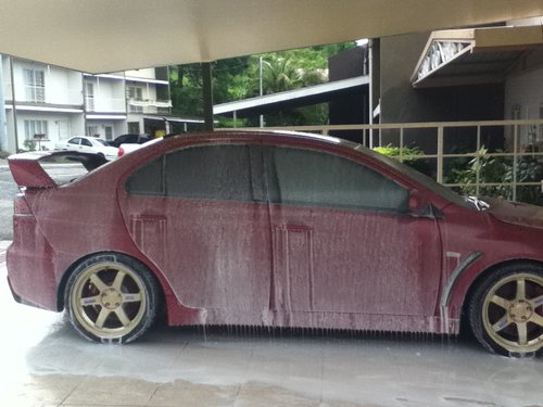

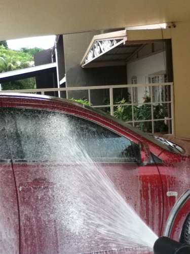

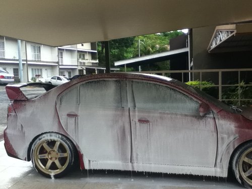

Chemical wrote:Ok, so after spending probably a few hundred hrs reading on auto detailing etc I think in theory I fully understand the process & keeping the vehicle looking @ its peak condition.
http://www.youtube.com/watch?v=nq6t8w-v ... re=related
(someone embed this for me pls)..thx
This presoak / car foam wash is what i'm trying to get. After all the research done this will eliminate swirl marks etc. Its purpose is to lift dirt, grime etc off the body of the car & trap it into the foam. Same principle as the latest car washes in Canada / States which is touchless.
(1) I'm thinking when using my p/washer to heat the water to a pretty high temperature & wash engine, wheel wells, wheels & body to loosen the dirt etc.
(2) Then apply pre-soak on car & simple green on engine & wheel wells. Let sit for approx 20 min for engine & 5 min for pre-soak, then rinse off with garden hose / p/washer.
(3) Once step 2 is finished, using running water, use a MF cloth & re-wash car.
(4) Finally drying will prob yield best results via high velocity blower after using the Hi-Tech Flexi Water Blade (made of surgical silicone) I tried the blower (high output) on the car & was amazed. It was borrowed !
WRT MF cloths, never wring it, squeeze it to remove water.
The p/washer I have is a Karcher 1600 psi so there is the bottle adapter to fit for the foam cleaner. Hadden & Co has stock of it or off amazon.
So i pulled out my Foam Cannon today here are some pics
