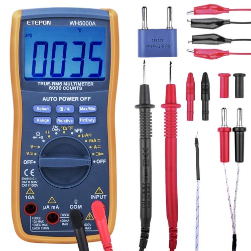

Hello there. Would like to put out some tests results obtained using a multimeter and cigarette lighter voltage display.
Tools Used - Innova Cigarette Lighter Tester & Etepon True RMS Multimeter. Got these testers to sell also for those who interested.
Engine Off | Ignition On
Cigarette Voltage Tester - 12.6v
Multimeter on Battery - 12.6v
Engine Running
Cigarette Voltage Tester - 12.5v to 14v [Not constant but rarely goes up to 14, basically most of the time between 12 and 13]
Multimeter on Battery - In the 13, rarely goes to 14.
Question is why are the readings seldom 14? Vehicle is a Mazda 3.

Here is my findings. I am using two pieces of tools, a voltage display on the cigarette lighter and a multimeter on the battery.
At engine off with ignition on:
[1] 12.6v on the cigarette lighter device
At engine off with ignition off:
[1] 12.6v on the battery using the multimeter
At engine running with no ac or anything else:
[1] 12.4v to 13.5v on the cigarette lighter device [it varies, does not remain constant]
[2] 13.5v at the battery terminals [constant]
