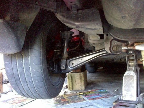

Ok so I went down in a big drain....
The body of the car did not bend,
I changed the trailing arm, control arm, all the small arms and the shock...
The wheel still kicking out...
I try to adjust what I could but nothing.... Everyone telling me my car f»«k up and I should sell it..
Any views will be appreciated...

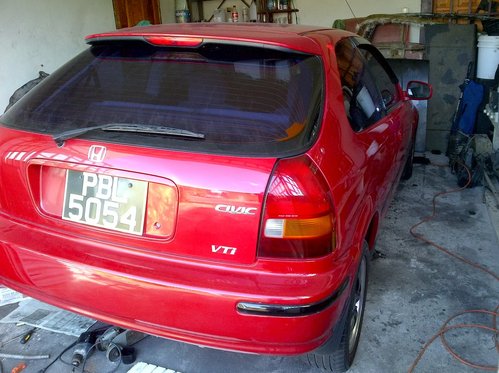

The rim did not bend plus I try another rim...
THIS SIDE LOOKING OFF TOO

ensure the rim did not bend and check the trailing arm

From the pic it looks like the trailing arm for real buddy.

yep just swap it out and no probs.

I changed the two trailing arms... So its not that I guess

^ take off both rear wheels and pull a tape compare measurement on both sides

Change the damaged side and that is all. Its no big fuss. It has alot of people around recently did a hub to disc swap including me. Call is you need any more info. 3981653

I changed everything.... I will call u... Thanks

The compensator arm at the front of trailing arm was replaced also?

Yes............k.....jdhswhej

Looks like your toe adjustment is really thrown off, or the part is damaged...did you check if this was good?

Yup I changed that too........

Could be that the one you bought is different or longer "don't know for sure if there's any difference in EG, EK" compensator arms...I know the trailing arms are the same in 92-00 civics, except for the brakes
IMO thats the only thing that could misaligned your wheel like that ....
did you check if the new was the same as the old? ....other than that im stumped......

The one I bought was from an ek3..... I going mad here.... I don't know that to do again...

red_dragon wrote:^ take off both rear wheels and pull a tape compare measurement on both sides
OP you try this yet ?

Yup... I am gonna change direction hub and c... Last try....
