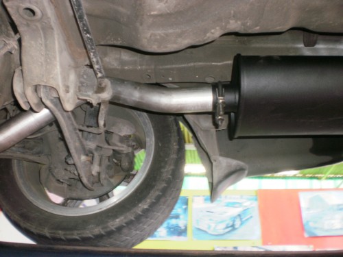

So this is what the 2 ½” set up looked like. Not very well done.

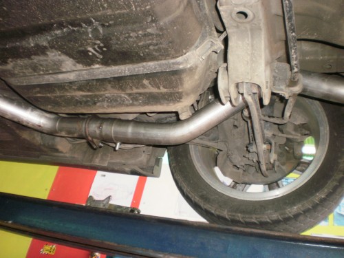

So I imported a aluminized Mandrel Bent Exhaust from TruBendz to redo the exhaust system. This is what it looks like. The quality was quite good and all the Hangers and Clamps were sent.

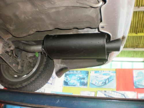

As you realize, no Resinator or Barrel came with the set-up, which was my choice. I had a CTR Barrel from a previous car to install and the Resinator was built by the Muffler shop.
So after a couple hours on the ramp, this is the new set-up. The Axle Back they sent could not work so a new Crush Bent Axle Back was built and installed. I am looking into this with Tru Bendz. The new set up is very quiet, which I expected. Next step is to do a dyno run and see where I am at.

JC : The Axle Back they sent could not work so a new Crush Bent Axle Back was built and installed. I am looking into this with Tru Bendz.
The exact problem . It would not fit or work with the barrel ?
Because that style axle over bend is not designed for OEM style barrels

red_dragon. there are 2 problems. the length of axleback is to short and the second bend from the front of the axleback was hitting the frame of the car. the hitting problem may have been sorted out if the complete system was lowered a bit but then the exhaust would touch going over humps.
on the length issue, TruBendz did indicate what you are saying about it being for an Aftermarket Barrel and it makes sense.
as of now, they have indicated that they can do a new Axleback to suit my application. i will be sending them what I require and they will make to suit.
I must say, they do have very good after sales support and responded very quickly to this issue.

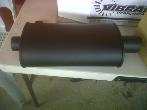

update : so i bought a vibrant barrel and got the tubing for the axleback. hoping to install this week.

so I installed the Vibrant Barrel today.
the people at TruBendz were correct. the Axleback they sent originally worked perfect on the barrel.
it was a bit short so we lengthened it and that was it.
the barrel of course is louder than the CTR barrel but is not a "fart cannister" :lol:
it has a nice low deep tone and is very quiet while idling.
i would recommend this barrel to anyone.
