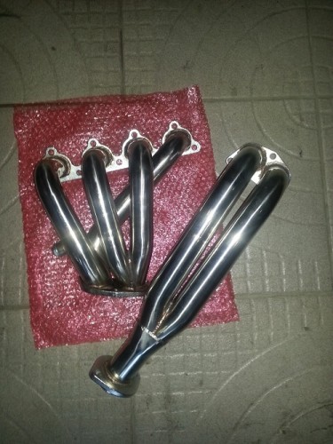

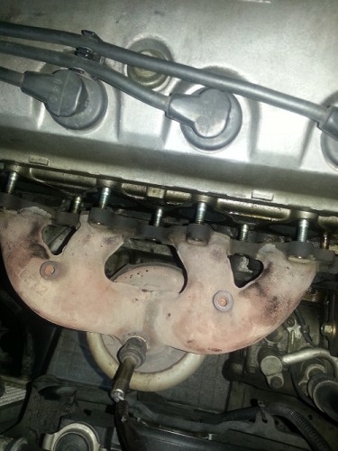

yea folks changed my d15b exhaust manifold with CAT to a header very simple job as shown
tools needed
- 12 , 13 , 14 , 17 spanners
- 22 for the sensors
- rags

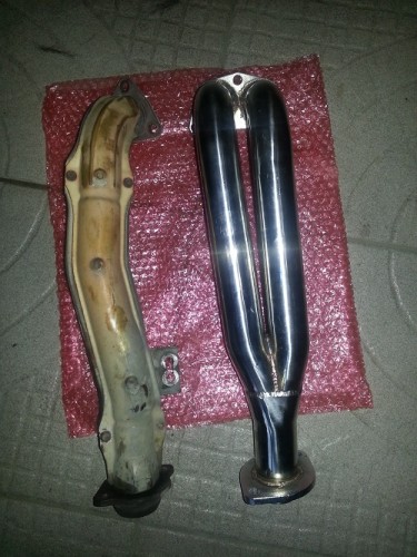

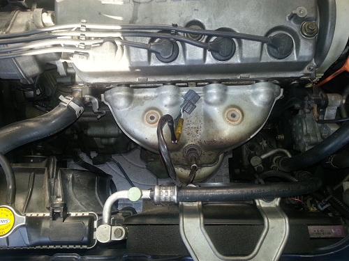

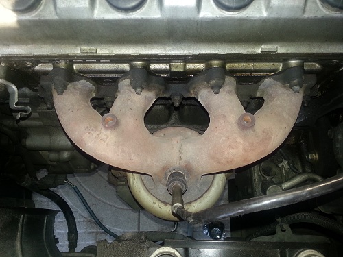

stock manifold

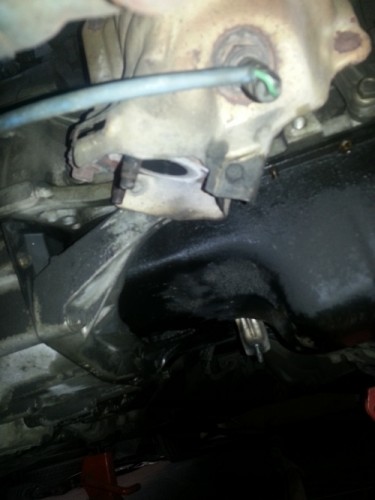

remove the 12 bolts for the shield and un jack the both oxygen sensors

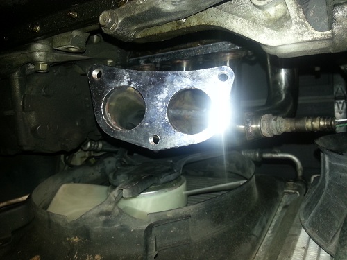

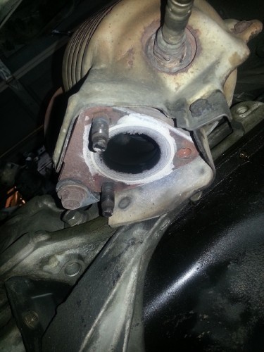

remove the 3 14 bolts from the bottom flange ....
also the remove the back flange its jus 2 bolts holding it up

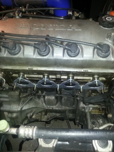

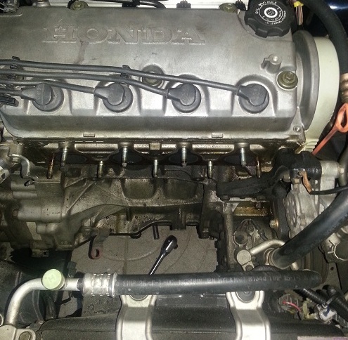

remove the 12 bolts from the top of the exhaust manifold
manifold removed also take out the gasket

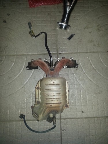

extractor Manifold

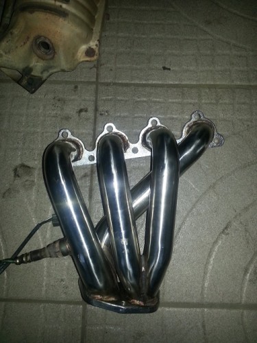

stock manifold with sensors

sensorn removed from the stock manifold and replaced onto the extractor manifold

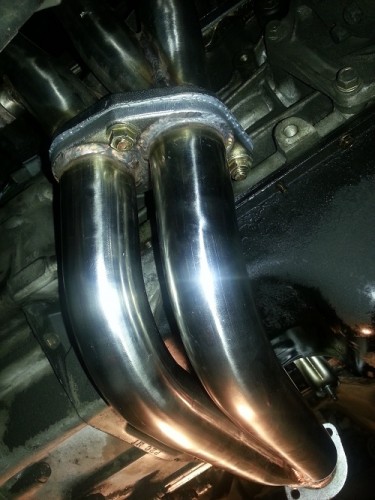

lower pipe
replaced Gasket with a new

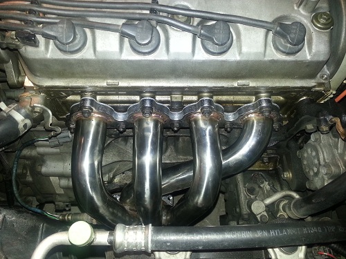

place manifold onto engine bolt up from the center go out so the gasket seats evenly

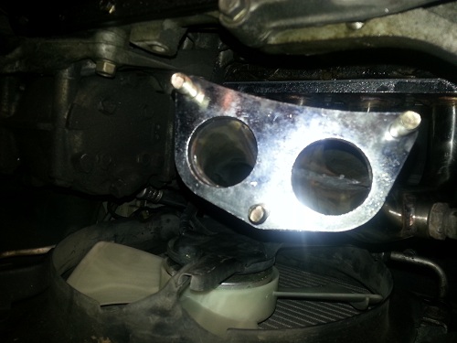

bottom flange
studs in place and tighten also fit up new gasket
tighten the 3 stud bolts
Job finish .... im goin to add a full cat back exhaust which i should bolt up later tonite
for those who will go the the exhaust guy to build a cat back you will save at least $400 - $500 if u install the extractor manifold yourself ...
