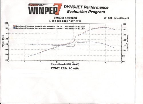

Dyno sheet before any bolt ons
SKUNKing up and dyno for 3pm will update you guys
Step1
Skunk2 Exhaust
Step2
Intake Manifold
Step3
Throttle Body
after each step i will take a pull to see gains, also will be taking back off manifold to port match after finial pull then revisit the dyno

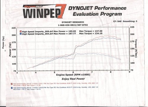

Postby High_Speed_Imports » January 18th, 2011, 12:14 pm
195whp/137.59tq
195whp/137.59tq

ok so 195whp is just with the exhaust? any other changes..fuel pressure, plug gapping?
High_Speed_Imports
Posts: 334
Joined: November 28th, 2008, 3:41 pm
Location: Neutral
Re: DC5/K20 dyno results
Postby High_Speed_Imports » January 18th, 2011, 12:32 pm
Racers Edgeupdated
ZimYes it is, as for tuning not getting management until Step3 is completed
Can easily cross 200 with just exhaust on stock motor. As for mine after cat is bottomed out so restricted flow some what.
stay tuned skunking up :D 220 stinks

Racers Edge wrote:ok so 195whp is just with the exhaust? any other changes..fuel pressure, plug gapping?
No changes what so ever didn't tamper with fuel,plugs or anything of any sort. Just bolt up and drive keep in mind i am bottomed out after cat so power is reduced. if it wasn't damage easy 200+

JDM_GUY Exhaust only
speedfreak44 shhhh doh let out d secrets :( or is just SKUNK2 :shock:
sti7 yea bro she is making power and moving quite well
Zim No tune stock ECU no K pro yet :D stock maps cuts everything

HSI... I did something similar but there was 6 month gap between putting on the muffler and going back on the dyno and when I did ... I did not see any gains.... I was told that I would need to do a basic tune,... clean injectors, gap plugs etc. and then dyno again...
So i'll be doing that soon and going back on the dyno.. but I'm trying to ascertain if you are doing anything different from me...

Racers EdgeI don't think that time period has anything to do with gains, probably just product if you did put on a exhaust you should see gains depending on brand of course. Some brand may take away sounding faster to you mind but dyno will prove you right or wrong.
For me i just took my stock exhaust down @ G4 and up with SKUNK2 went to dyno the weekend
I saw you mention base tune do you have a management?
