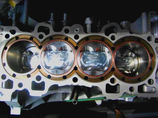

MOTOR: is a 84.5mm Sleeved GSR, with 10:1 CP pistons and manley Turbo Tuff rods.
The head is a port and polished B16a2 head with a Crower valvetrain and Skunk2 Tuner 1 cams.
TRANS: GSR with ITR diff and final ( won't last long) :(

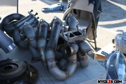

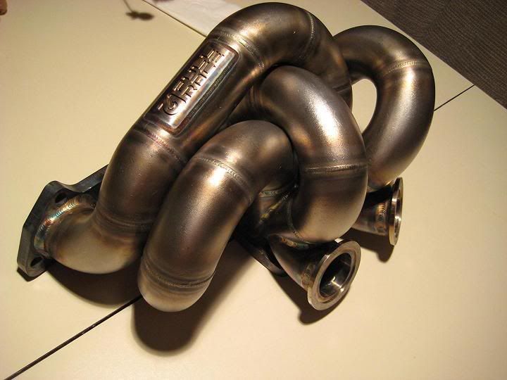

soon it will be the NEW Full-Race twinscroll bottom mount manifold
with the Borg Warner S372 turbo,3"-4" downpipe, 2 Tial 44mm gates, Precision 825hp core cooler, 3" cold side charge pipe and 2.75" hot side, 1200cc injecotrs ( soon to switch to 1600cc) and a tons of other misc sheit.

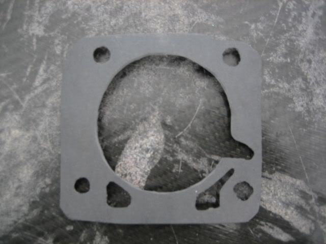

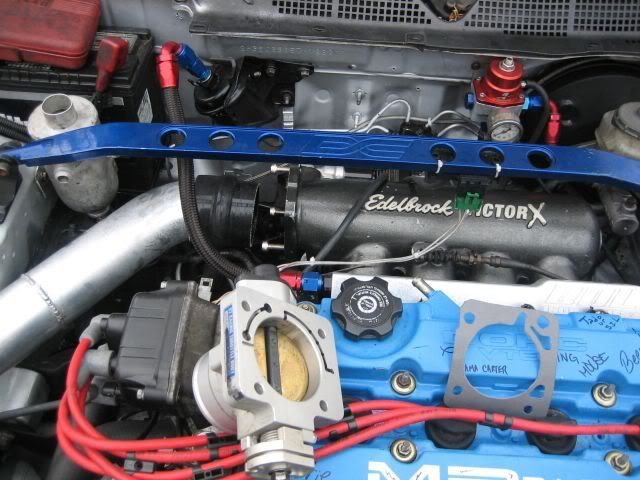

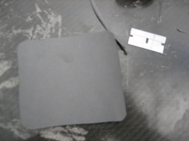

Well i had a little issue with my damn Throttle Body gasket, it was leaking at 2 points.
could not find a Gasket, or a shop that would part with TB . So i made my own!!
FlePro rubber based Gasketpaper, a nice sharp blade, a hole puncher,and the core of a pen to mark off the tight places to cut.
install

GSR 84.5mm Darton sleeved and copper o-ringed block
10:1 CP pistons
stock Ls crank
Manley turbo tuff Ls rods
GE headstuds
Oil squiter block offs ( they hit with the use of Ls rods and crank in a GSR)

Skunk2 70mm TB (soon to swap out, because it gets stuck a lottt)

MB Racing T3 topmount turbo manifold (Full-Race T4 topmount, dual gated for now till the new bottom mount manifold becomes avaliable to the public)

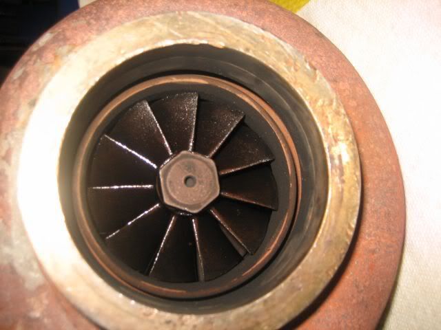

Full-Race T67ho turbocharger (BW S368 now, the T67 quit at 760'ish whp).

The materials for the cage has been ordered. And i just picked up a nice shop sponsor to help me out this season!! :D
Big Thanks to Chirs Harris @ Xenocron!! ( this is one of thoes dudes that you would Rep even if he wasn't hepling out, he is just that good of a guy)
I'm Proud to Rep
And new T4 divided Topmount via MB Racing!! 8-)

Posts: 147
Joined: June 26th, 2008, 1:49 pm
Postby B20VTEK » February 3rd, 2009, 5:41 pm
very very nice pootie
B20VTEK
Posts: 147
Postby B20VTEK » February 3rd, 2009, 5:44 pm
Pootie wrote:well it's been some time.
I'm Proud to Rep
i thought u were going with a full race manifold this time
also i have been hearing a lot of good things with the bosh 1000cc injectors. should be able to up the fuel pressure and support your goals.
Pootie
Posts: 36
Joined: December 23rd, 2008, 10:36 pm
Location: Manhattan NYC
Postby Pootie » February 3rd, 2009, 6:59 pm
Yea, i like the Bosh. I already had 1200cc Percison injectors (i'll run them till i have an issue, then swap them out for the Bosh).
And i'm getting local help. So F-R will take a back seat, plus Geoff won't release the manifold i want till spring . ( thats why i went with the MB manifold, it will do the job)
Free owns> Full Price anyday!!

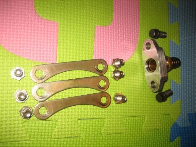

Postby Pootie » February 6th, 2009, 10:59 am
well no real update yet. It's been 15*-17* the past few days. And i just don't feel like looseing a finger or toe to frostbite.
So i'll post a few pix of my "back up" turbo. But this used to be my back up turbo last year. It won't bust a grape ina fruitfight on this build.
so it's for sale.
Rebuilt Air Research turbo
T4 Divided houseing 1.00 back
.60 trim wheel ( i think, lol still havent measured it)
3" v-band
no shaftplay or leaks
about 300 miles on it
asking $300US ( will trow in a free set of M&H 22" x 8" x 13", with 4 passes on them, still plenty of meat)
will support 500-550 whp.
