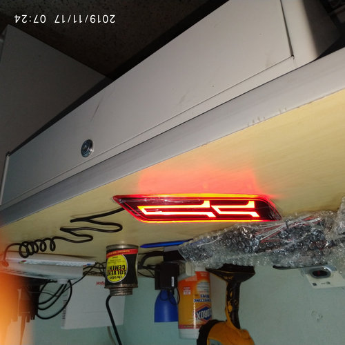

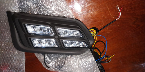

Mods for sale
Pm if interested
Led rear reflectors
Drls for Honda city cng/grace hybrid

Is it true that you ha e to write the transport commissioner for extra lights.?
Drls
