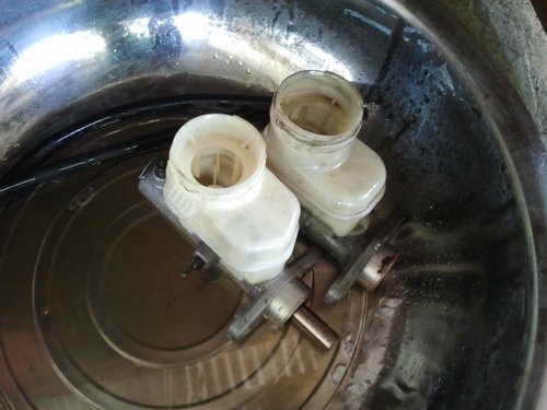

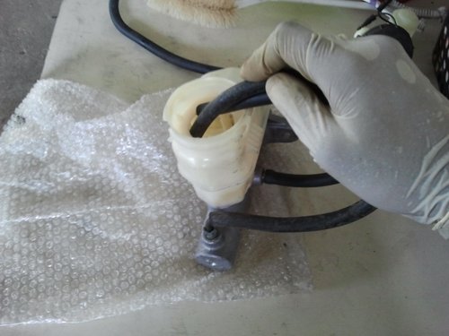

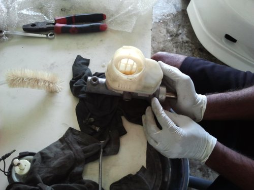

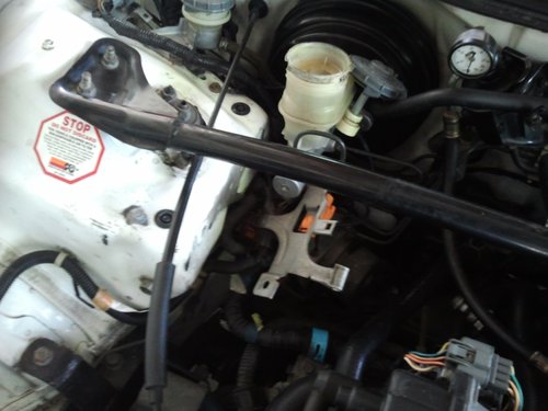

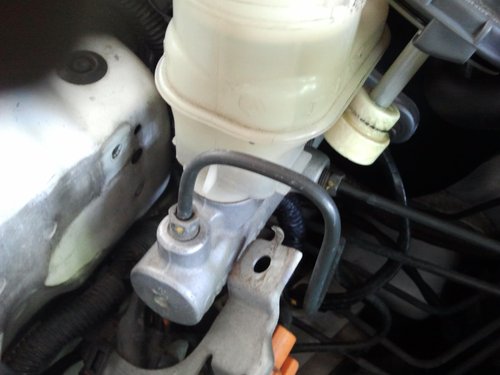

Postby JDM_GUY » February 17th, 2013, 10:17 pm

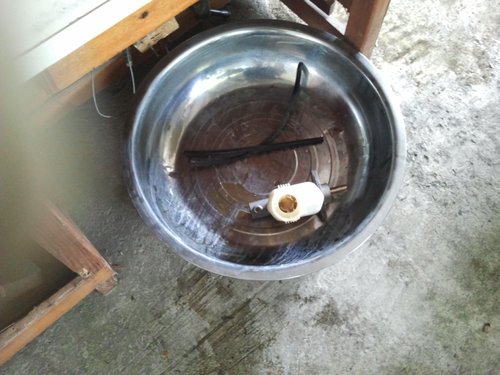

CTR upgrade

how does stopping power compare?
JDM_GUY
Posts: 1556
Re: JDM Guy's Car Blog Thread
Postby JDM_GUY » February 18th, 2013, 9:21 am
Haven't tested it yet. Will drive the car weekend. For now it sits in the garage.
r3iXmann
Posts: 4299
Location: Straya, m8.
Postby r3iXmann » February 18th, 2013, 9:47 am
you installed brake components and did not test? :shock:
JDM_GUY
Posts: 1556
Postby JDM_GUY » February 18th, 2013, 8:27 pm
YEh....
X2
Posts: 8649
Postby X2 » February 18th, 2013, 11:03 pm
Whats the size difference to and from ?
JDM_GUY
Posts: 1556
Postby JDM_GUY » February 19th, 2013, 9:22 am
7/8''-1''.. the pedal def feels better.
