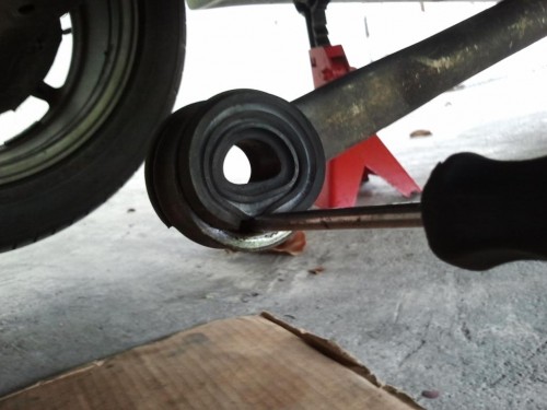

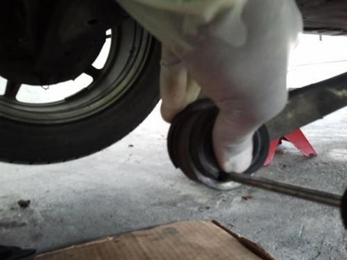

Loosen the upper control arm bolts to take a look at the bushings on the camber kit, oh boy was I in for a surprise:
Upper arms off:
Turned out I had a bad camber ball joint so that would explain the off alinement of the wheel:
Gave the arms a little clean:
Put some tape to mark where the camber kit goes:

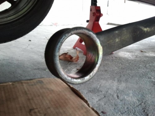

The bushings on the arms looked good but when I properly looked I saw they were ripping, thank god I had a set of ES bushings put down in case this happened:
With time passing on Thursday I went to the nearest parts shop to get a 555 ball joint. Set me back $175.00. But I needed it to head to couva the next morning to get the kit sorted out.

New 555 balljoint installed:
ES bushings installed after they burned out the old bush:
A little burnt paint but no one needs to see that under the car:
Oh my there she sits waiting to be loved:
So time to reinstall the arms:
Installed with pin:

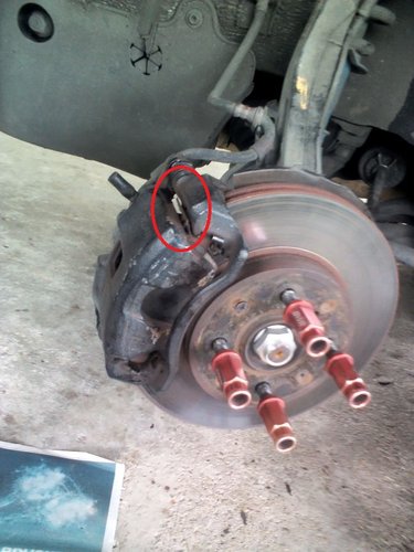

Next was to service the brakes, got the proper pin silicon grease:
Pins with old grease, see how hard it gets because of the heat:
All cleaned up:
New silicon grease:
The upper was in the worse condition, and to think I just service them last year, I could only image those that have never been serviced:
Cleaned:
Took the pads out and used a steal brush and gave them a good clean:
All done and remounted, gosh they need a sand and pint. Next project...

sound boy 64
The skunk 2 ball joints are crap, they only last about 1 year ($350tt), I bought this camber kit last year jan and by july the left side went and iam sure the right side blew long before I noticed.
The 555 retro fit ensures me of a quick fix next time, all i have to to is press out the old ball joint and press in the new one. Its that simple, I don't ever have to machine the camber plates.

JDM_GUY I have a question..what issues occur when the pins (pistons) in the calliper don't have grease.. I noticed you cleaned them up nicely.. was just wondering so i'd know if i get any specific problem it could probably be that.
JDM_GUY
Posts: 1556
Re: JDM Guy's Car Blog Thread
Postby JDM_GUY » April 28th, 2014, 2:12 pm
JJ16 wrote:JDM_GUY I have a question..what issues occur when the pins (pistons) in the calliper don't have grease.. I noticed you cleaned them up nicely.. was just wondering so i'd know if i get any specific problem it could probably be that.
You will notice one side cutting the pad more than the other. I notice that on the left side hence the reason I bought the correct grease and did the job.
or the brakes will lock when u mash and take a while to release , happened to mines when i installed the DC2 once greased up works bess

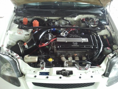

Time to service the spoon sports TB, took of the intake:
Shot of the TB
Cleaner used
All cleaned up
Decided to pull the plugs and give them a clean
Fresh oil in
All done, so mounted up and washed down the bay, then started up to burn off the water
