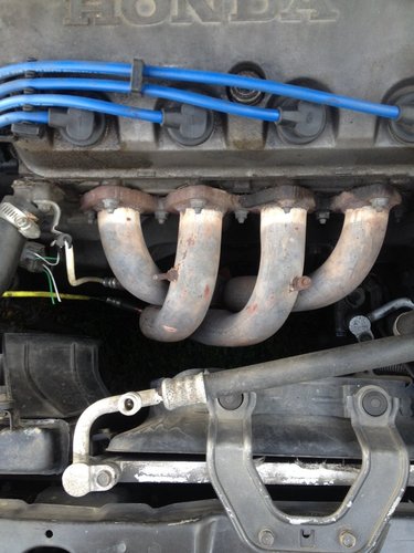

Postby Kerrons101 » April 9th, 2014, 5:40 pm
I have a d15b engine that giving me some problems, my check light stays on when I start, I diagnose it more than one place they said it's the o2 sensor, can't locate foreign used sensors in the north. The problems I get with the engine is that when I put in reverse the car go high and low and when in neutral the rpm is above 1000 and when it's in drive idling it goes right. Down to 0. Question, can the o2 sensors cause this problem?? And if can u help me find someone sort this problem for me I'm willing to pay whatever it takes.

Which O2 sensor does your engine carry? One or 4 wires?

Postby Kerrons101 » August 25th, 2014, 1:17 pm
4 wires and it has 2 o2 sensors

Do you know which sensor is throwing the code?

It's a non Vtec engine cvt tranny, the sensors on the extractor

I didn't get thru, I did all that too and my check light still on so d only thing I'm thinking now is changing the o2 sensors n moving 1 from d other as u could see in the pic they're too close to each other

Postby Kerrons101 » September 5th, 2014, 11:22 am
Yea guys I got thru with the problem, changed both sensors ( foreign used ones) and my check light is off, only thing tho when I'm on the highway n I mash down to do some numbers it comes back on. What could be the rel issue now???
