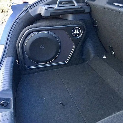

Looking to do a corner box similar to this...
Posts: 9527
Re: Subwoofer advise needed...
Postby X_Factor » December 31st, 2019, 3:39 am
Sub box like that would cost atleast 1000
If u using a basic sub with plans to upgrade later I won't do a glassed box yet since it would be built around the sub you are using and may not work with a sub when time to upgrade in terms of cut out diameter...volume...porting
Imo when you get the sub u plan to keep for a while then consider the glassed box

X_Factor wrote:Sub box like that would cost atleast 1000
More like $2000 man!

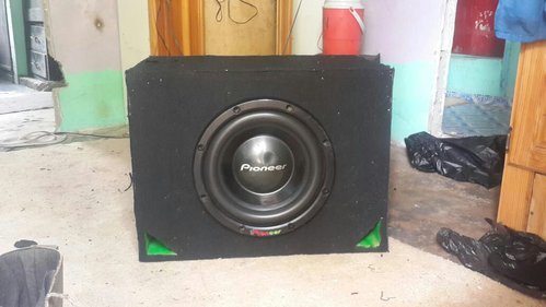

Local Build of Similar:
wheel whores
Posts: 703
Joined: November 23rd, 2008, 7:24 pm
Location: on the slow lane
Postby wheel whores » December 31st, 2019, 3:07 pm
kavaninho wrote:Local Build of Similar:
Looks good
